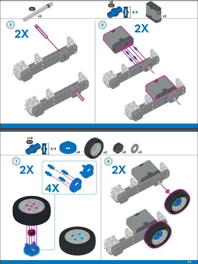

- Ensure the drive shaft fully inserts into the motor. I’ve attached an image of the Build Instructions showing this procedure. When all is said and done, you should be able to hear and feel the motor engaging when the wheel is turned. Please see this video of me turning my BaseBot wheel, where the motor is clearly heard. If you are able to hear the motor engage when the wheel is turned, that is good news! Move onto step 2. If you are unable to hear/feel it, please double check the shaft is inserted into the motor.

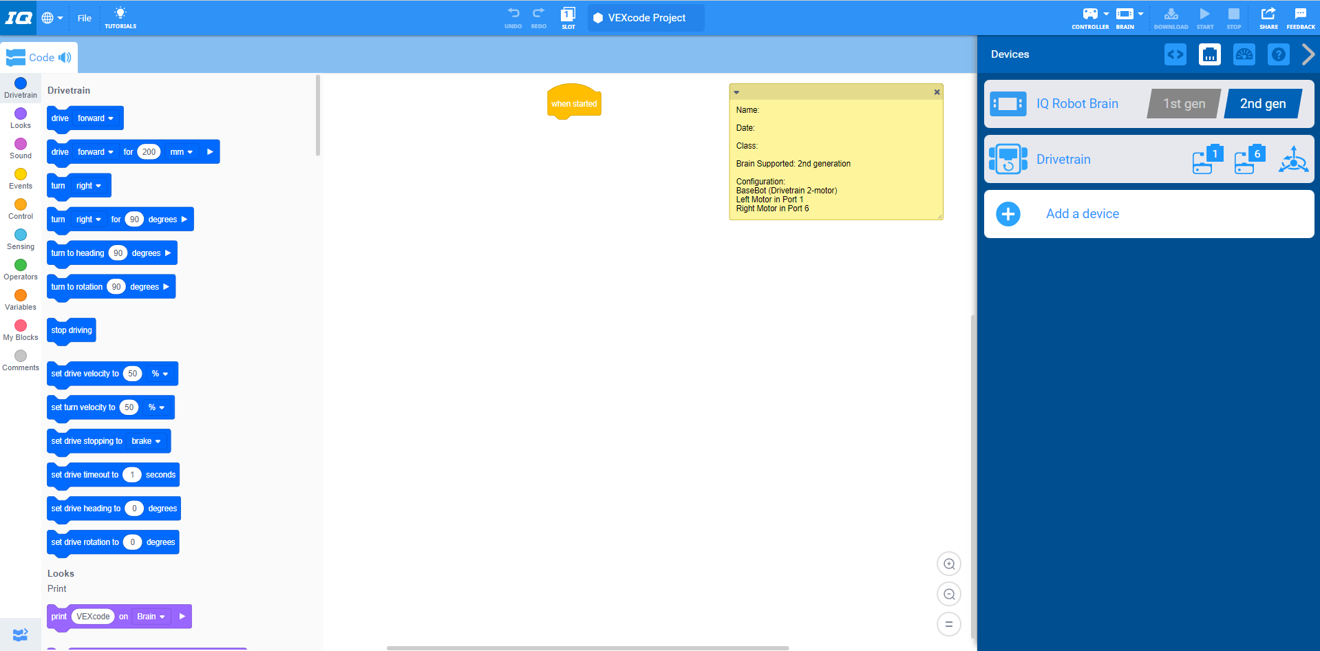

- Upon opening the BaseBot template in VEXcode IQ, when I select the Devices tab, I can see there is a device already configured, utilizing the same ports as prescribed to me from the build instructions. If you configured your own device, did you correctly select which ports your motors are plugged into? Would you be able to provide images of your configuration?

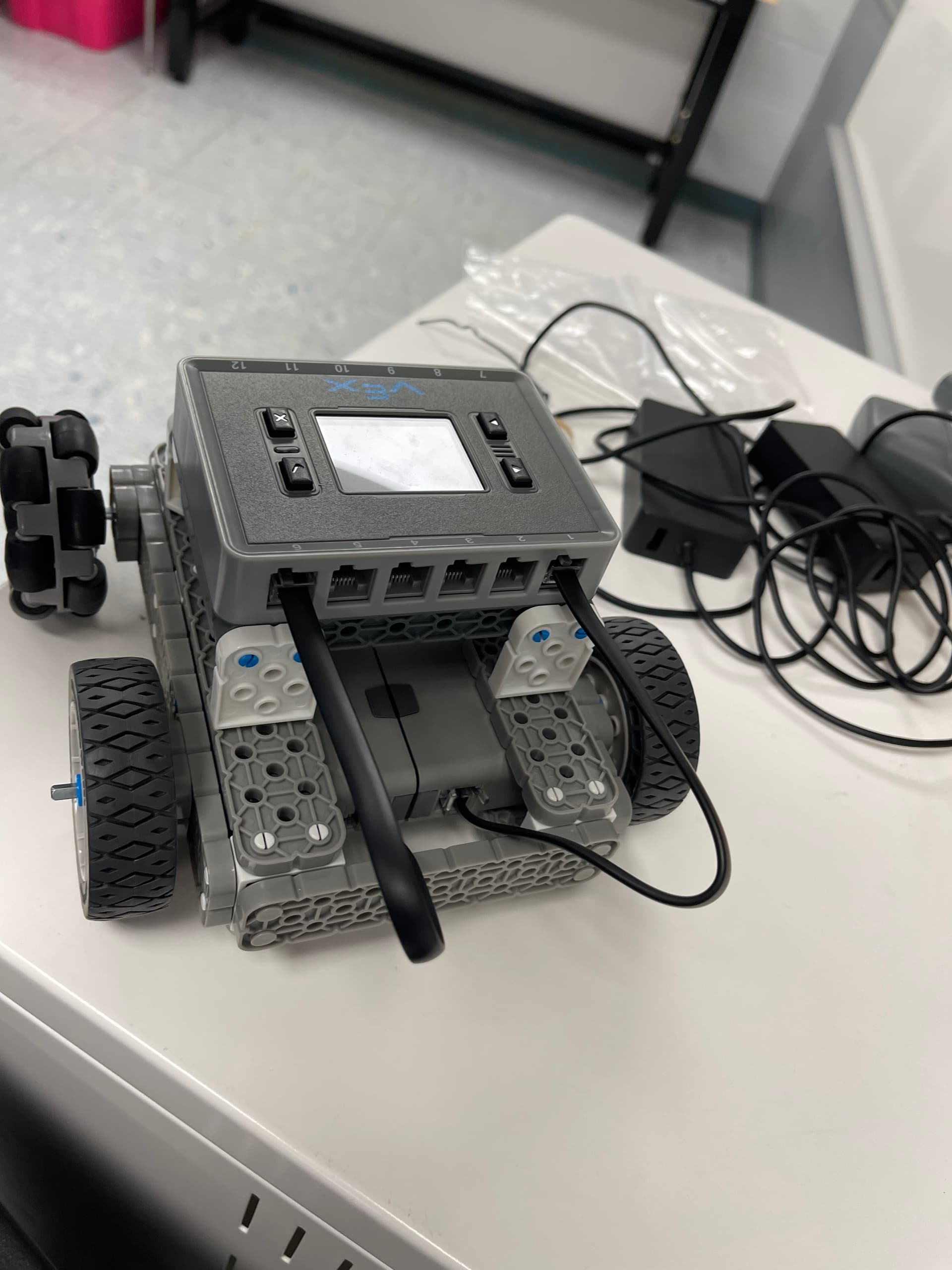

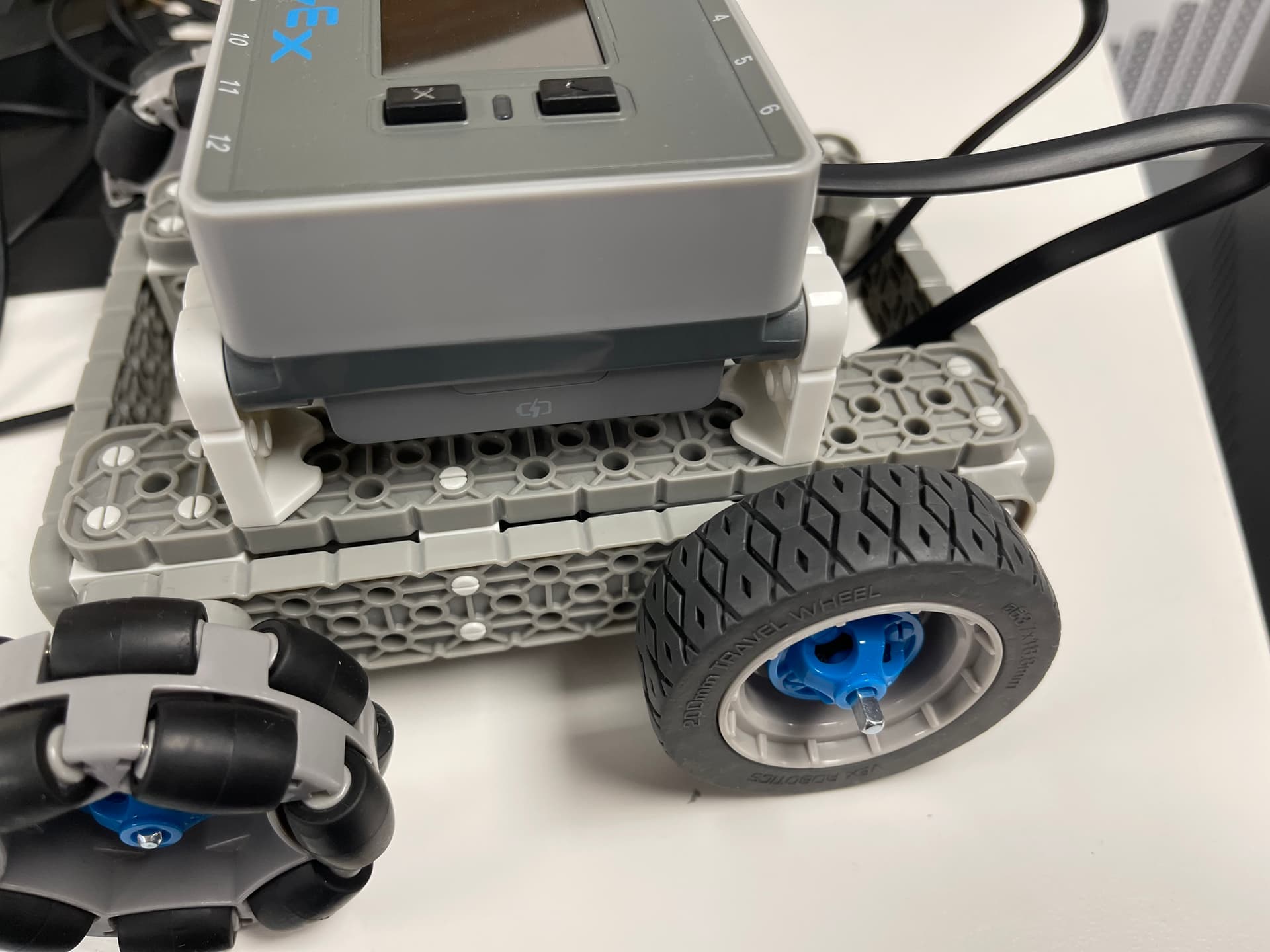

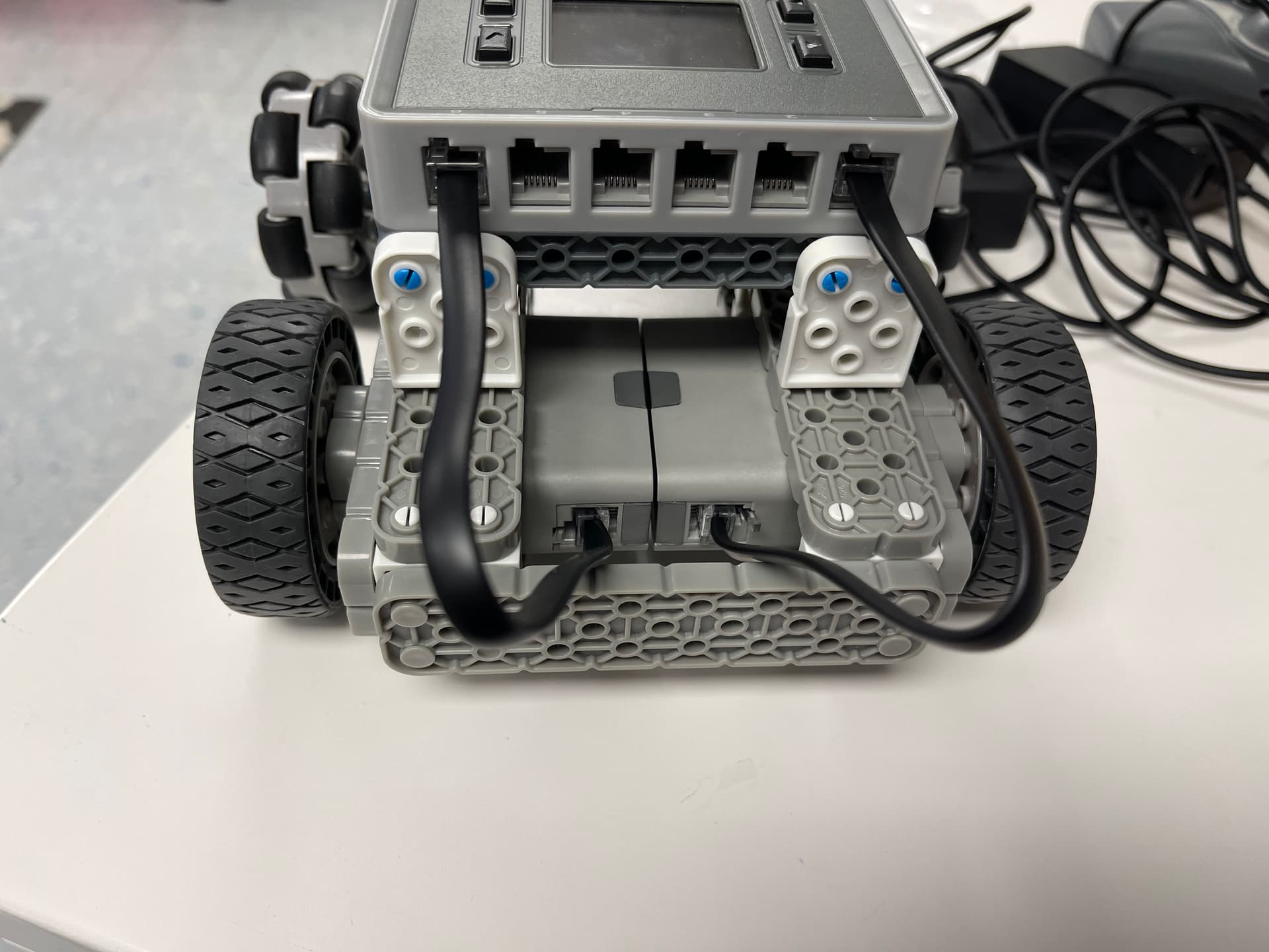

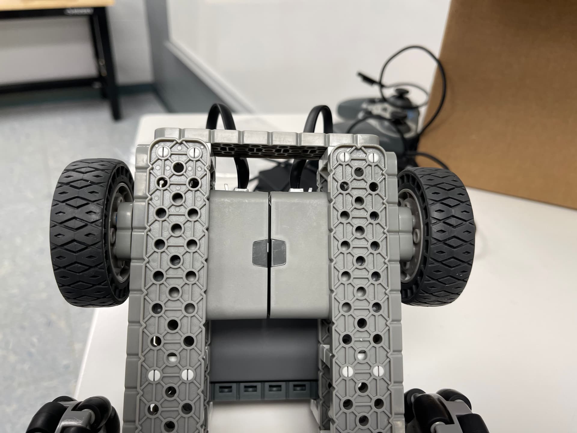

Hi @Brandy_Horton! Thank you for sharing these images! Are you trying to run the built in Driver Control program, or your own code that you created and download to the robot?
built in
@Brandy_Horton got it, thanks ![]()
