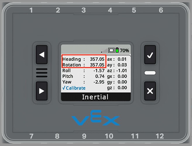

Calibrating the VEX IQ (2nd gen) Inertial Sensor can sometimes result in an incorrect calibration, where the heading and rotation readings are inaccurate by a noticeable degree. In order to obtain the correct readings, the Inertial Sensor will need to be deep calibrated.
For example, your Inertial Sensor will need deeply calibrated if: when the Brain is rotated 360 degrees, the Inertial Sensor will report a 357 degree heading and rotation. You’ll notice this is more than approximately half of a degree margin of error. Anything more than one degree should be deeply calibrated.
