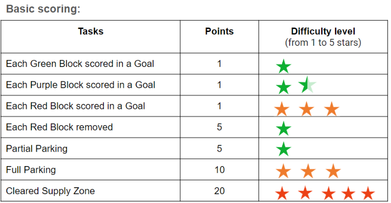

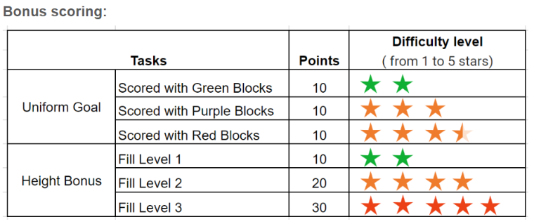

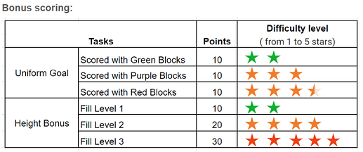

The Full Volume contains 3 Goals, 73 Blocks, and 1 Supply Zone. According to our previous exploration experiences, we can evaluate the tasks’ scoring efficiency and difficulty levels. The following table is an example (please note that individual perceptions may vary).

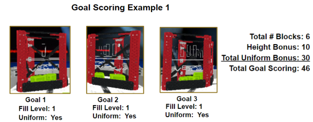

We can start by selecting some easy tasks strategically to complete while making sure to obtain Uniform and Height Bonuses to maximize our scoring. For example, we can opt to complete the scoring combination illustrated in Goal Scoring Example 1, remove three Red Blocks, and accomplish partial parking. By doing so, we can attain a total of 66 points!
score example1

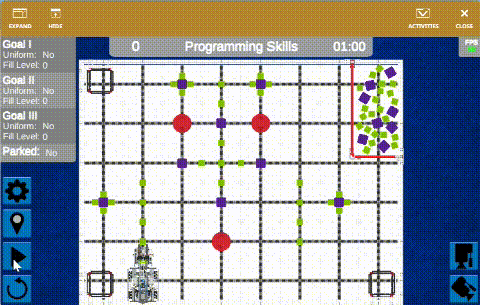

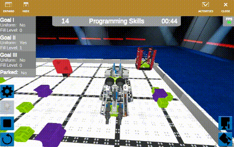

The following GIF demonstrates the execution process of Goal Scoring Example 1 in the VIQC Virtual Skills.
score66 (1)
We can see that after completing all the selected tasks, we still have 25 seconds left. This time provides us with an opportunity to accomplish the Full Parking task, which would boost the score to 71 points. In addition, we can also score more Green Blocks into the Goals to improve our overall score!
score71 (1)

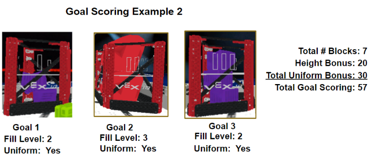

In the previous strategy, we successfully acquired the Uniform Bonus for all three Goals. At this point, the most effective approach to boost the score is to increase the highest Fill Level shared by all three Goals to earn more Height Bonuses while maintaining the Uniform Bonuses. There are various ways to fulfill this aim. The following image shows one example.

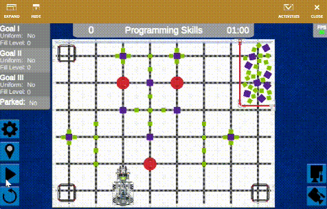

The following GIF demonstrates the execution process of Goal Scoring Example 2 in the VIQC Virtual Skills. Now we received a total of 82 points!
score82

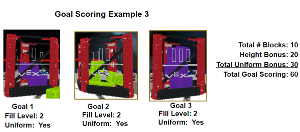

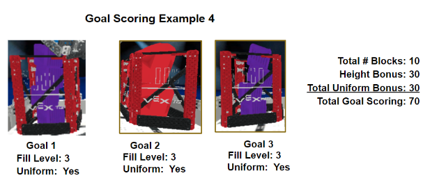

Do we still have a chance to improve the robot’s performance in the game? Absolutely! For instance, accomplish the scoring combination illustrated in Goal Scoring Example 3 or Goal Scoring Example 4.
example3
example4

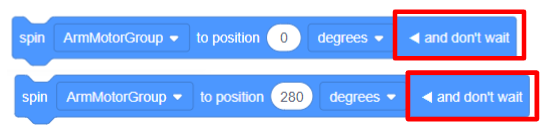

  1. Minimize the time needed for Virtual Byte to complete the process of scoring a Block. Enable the robot to raise or lower its arm while in motion using the and don’t wait feature of the spin ArmMotorGroup to position block.
    code blocks

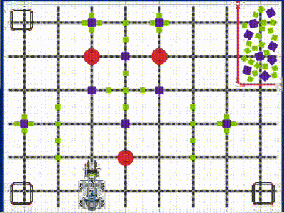

  2. An efficient route plan empowers Virtual Byte to accomplish more tasks within the limited game time. The shorter driving distance and smaller rotational angles result in less travel time. Furthermore, an efficient route design can prevent the robot from driving onto Blocks, which could cause deviations from the target.
