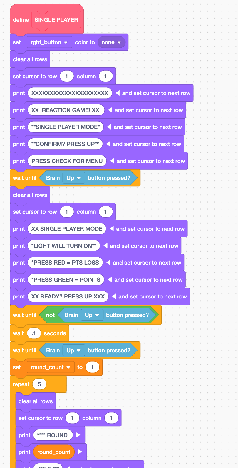

Here are some pictures of the sample game I came up with (I would put this level of work at a high school level but it is possible to make a game that is more simplistic):

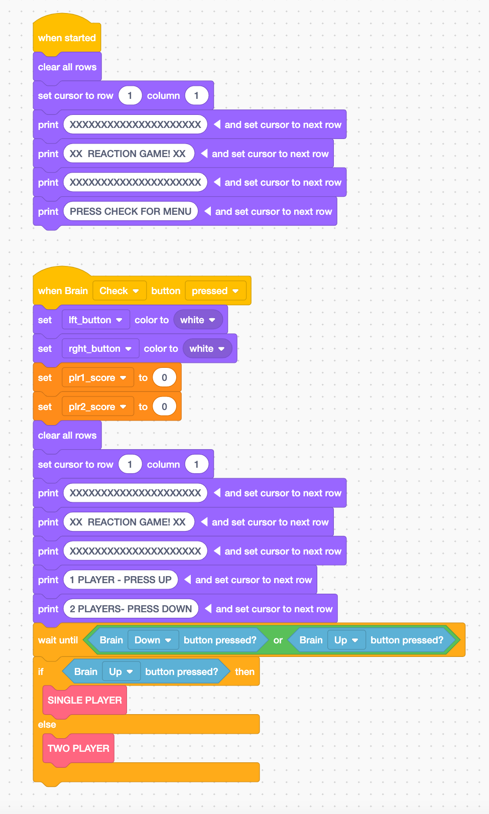

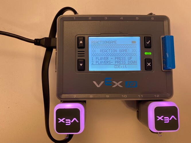

Startup screen and main menu screen:

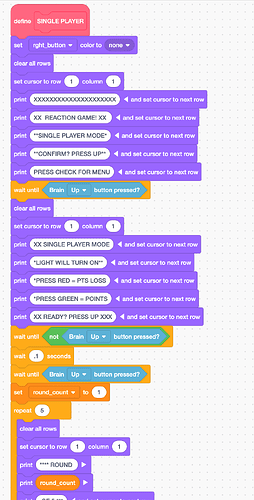

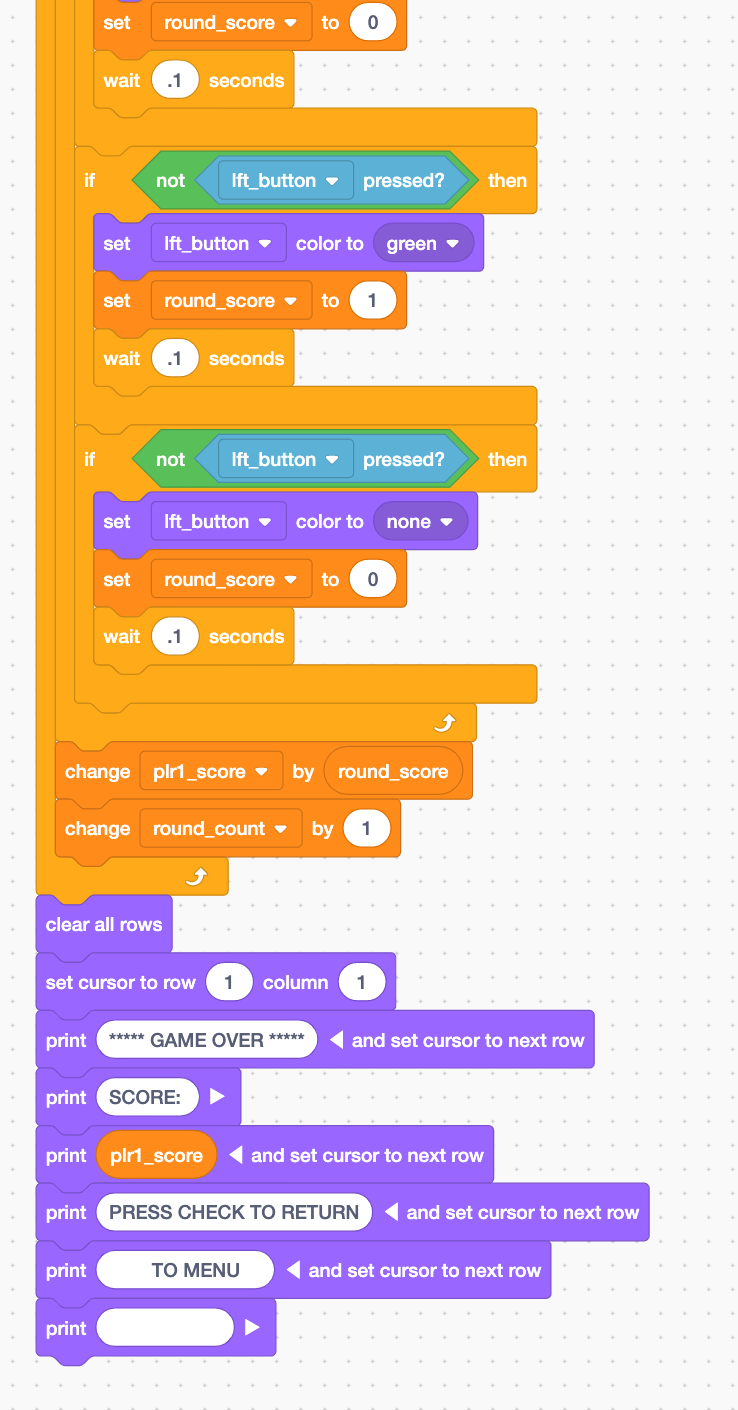

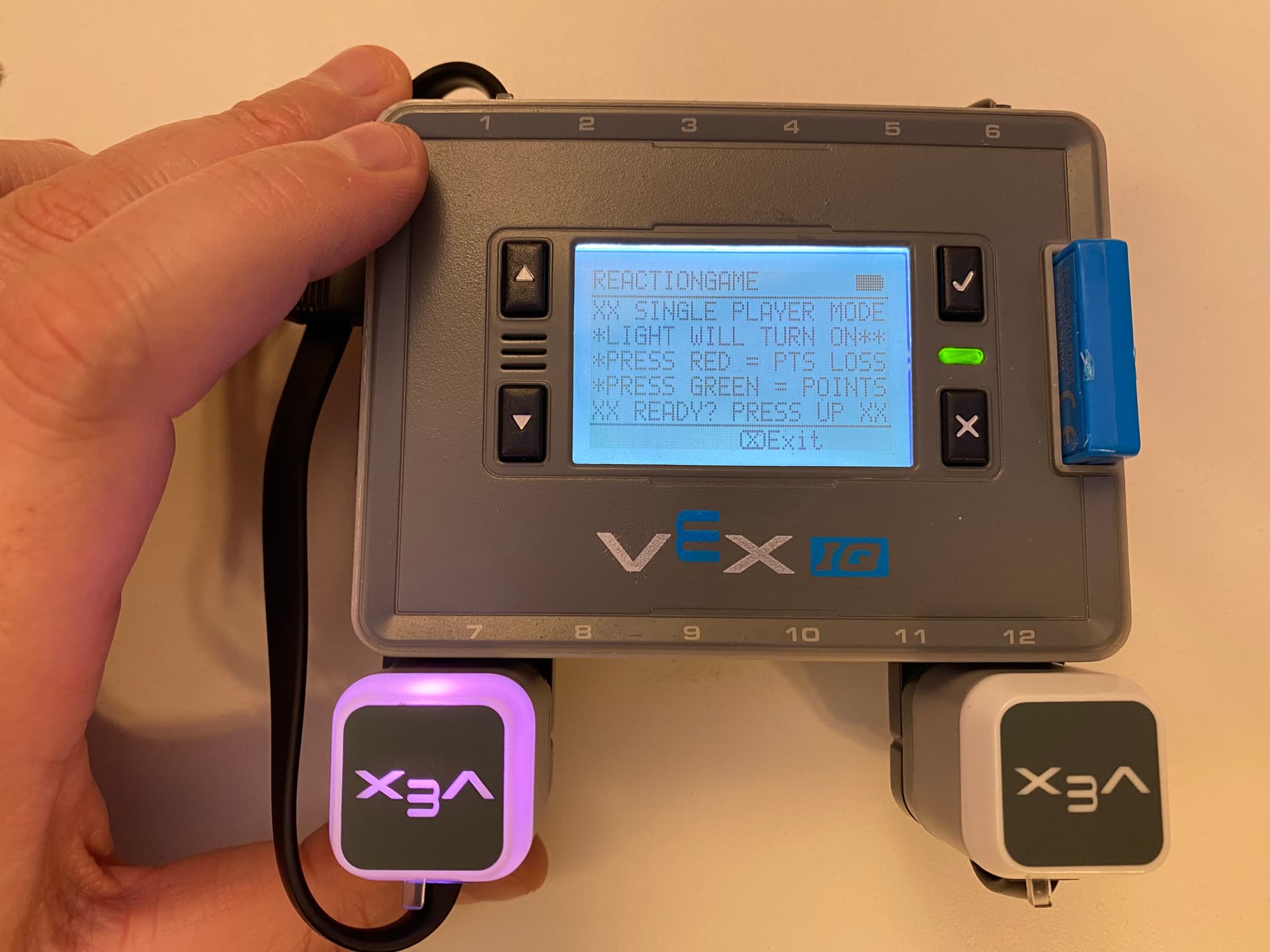

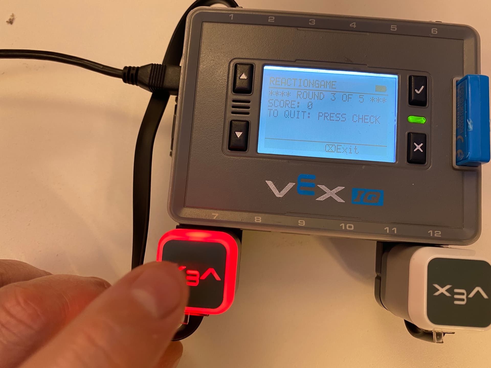

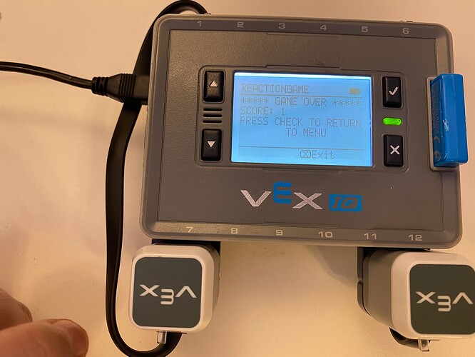

Single Player - Instructions and 5 rounds of play:

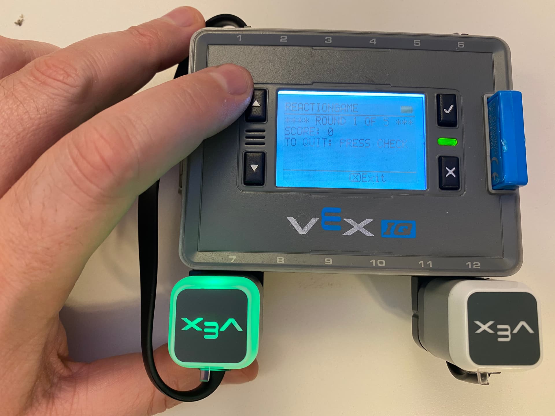

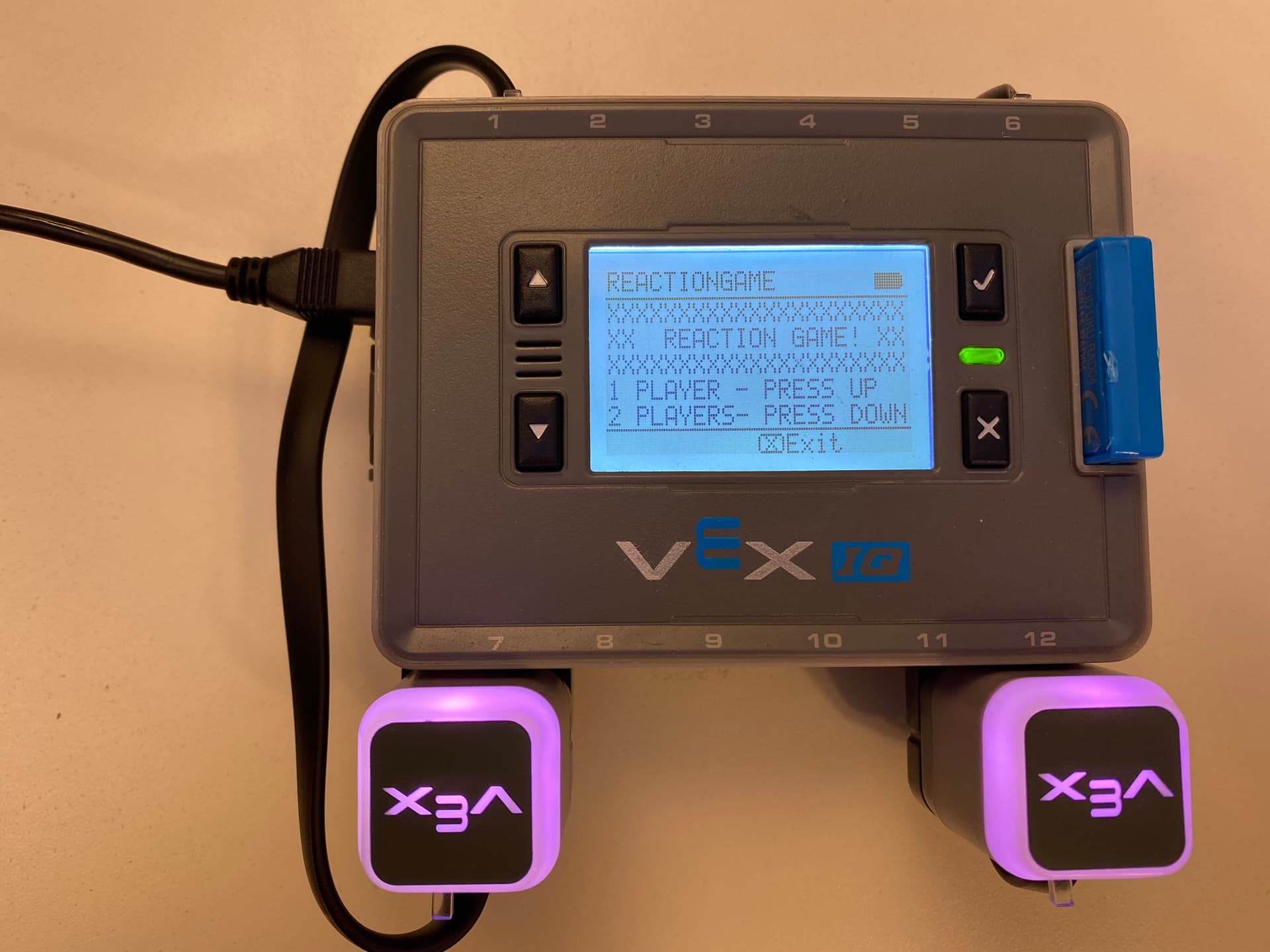

Here is what it looks like on the brain:
