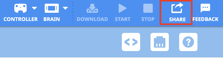

Use the ‘SHARE’ feature in VEXcode IQ. At the top right of VEXcode IQ, there is a ‘SHARE’ button. This will export a PDF of the students current code that they could submit to you for review. This would allow you to get a quick glance at each student’s code and assess it as you see fit.
