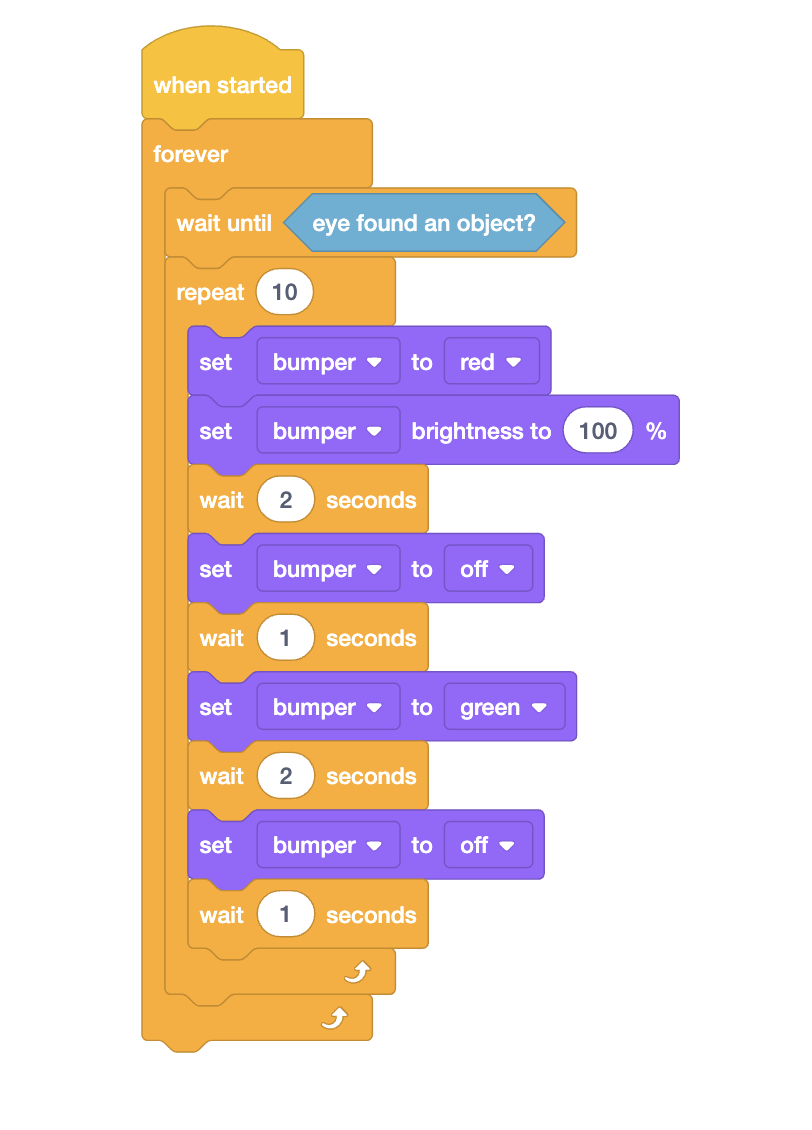

I was inspired by the super cute VEX 123 Rudolph the Red-Nosed Robot @Audra_Selkowitz made in response to @Desiree_White-Price 's holiday activities question, and just had to make a GO version. Here’s what I ended up with:
It’s goofy, but fun! I used the LED Bumper as the nose, and added the Eye Sensor so it would activate when someone walks up to my office door. The brain and the battery are attached together behind the plate that is Rudolph’s face, and I used a command strip to attach it to my wall.
Here the code I used, in case anyone else out there wants to make one!

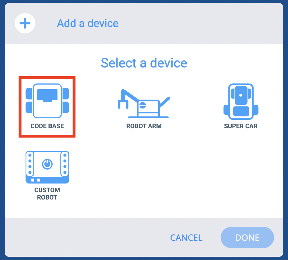

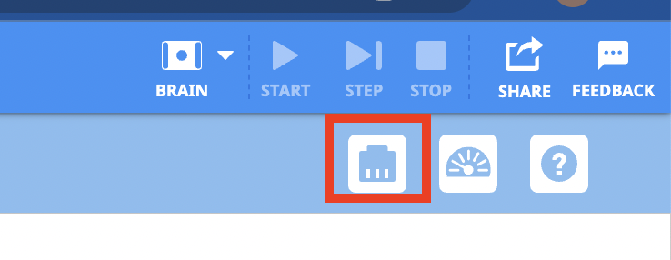

@Aimee_DeFoe I built the reindeer and connected the brain to VexCode Go, but I don’t see any eye sensor or bumper blocks to add to the coding program. Any suggestions?
I’m so glad you are trying this, @Tina_Dietrich ! I think you may need to configure your robot and that is the reason you don’t see the Sensing blocks.
Go to the upper right hand corner of the screen in VEXcode GO and select this icon:

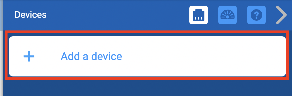

Select ‘Add a Device’
Then select ‘Code Base’ and click the ‘Done’ button.
Then all the blocks you need to code the Eye Sensor and LED Bumper will be in the Sensing category of the Toolbox.
Let me know if this solves your problem!
@Aimee_DeFoe It worked…thanks!
