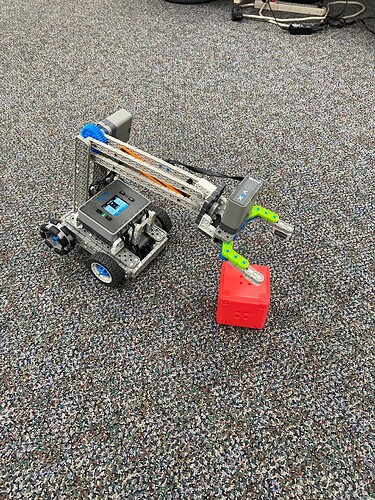

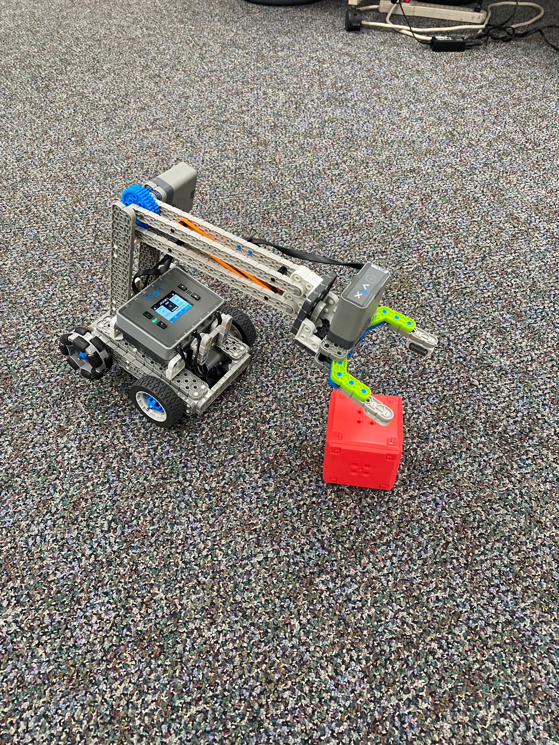

Followed the build plans, and am running into this issue. I know I can add weight to the back but any other suggestions? It’s hard to see but the back wheels are off the ground.
Chain drive your claw moving the motor back over the wheels, this should help move the CG back over the wheels.
