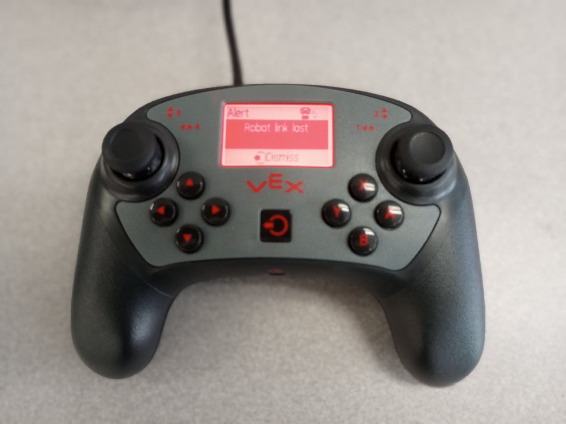

I have two issues. 1) I keep receiving this error when trying to sync controller to the brain wirelessly. It works fine when I plug it into the brain. When I unplug and try I receive the error message. 2) On my second speedbot the forward and reverse works fine but my left and right is backwards. How do switch the controllers to work properly?

Hi @Lauren_Harter! Thank you for your response.
Issue 1. Yes, the radio is installed. I followed the article you posted as well. It worked before, just not sure why it stopped working.

Hi @David_Wettrich! All of that sounds good, thank you for the information.
For issue 1, do you have both the Brain and Controller set to VEXnet or Bluetooth? If VEXnet didn’t work, maybe try setting both to Bluetooth to see if that would fix it. I can help you do this if you’re not sure how.

Hi @Lauren_Harter,
It’s working now after going back and checking everything again. (Note to self: check and recheck everything)
For issue #1 I unplugged the cable going to the radio a couple times and now it works. Must have been a loose connection. I also tried switching from VEXnet to Bluetooth before I tried reconnecting the cables.
